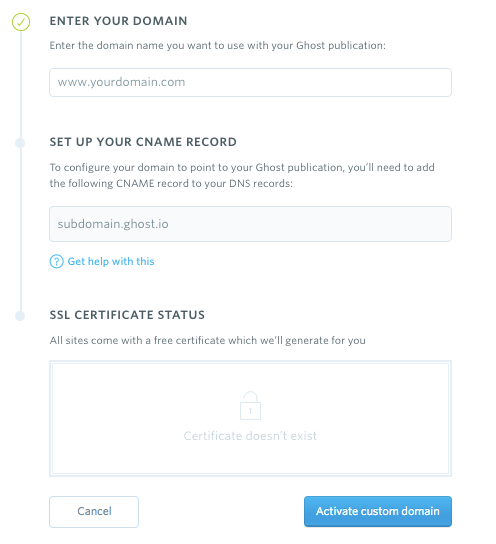

Step 2: Activate the Custom Domain
The final step to complete your custom domain setup is to go back to Ghost.org and activate your custom domain.
- Log into your Ghost.org account at my.ghost.org/signin and setup a custom domain in the "Domain Settings" section.
- Enter the desired domain into the custom domain field on my.ghost.org. Always use the full domain you intend to use, including the subdomain. Omit the subdomain if you're using a root domain.:
- Activate your custom domain - this can take anywhere from a few seconds to a few hours due to the length of time your DNS takes to propagate.
- Once activated, you can view your publication by going to the custom domain directly from the browser.
